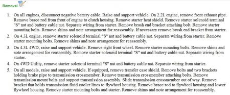

Hi, My starter just went out on my '98 Chevy. My fiancee and his friend removed the bolts and got the starter a third of the way out..they have jacked it up and tried everything to get it out and it as if it is caught up on something...any suggestions to get it the rest of the way out and if so..what about getting the new one in?? Thanks : )
