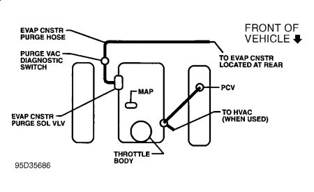

evap system diagram - pcv valve location?
1998 CHEVROLET BLAZER
15,058 MILES • 6 CYL • 2WD • AUTOMATIC
GERALDGLITTLE
where the PCV valve mounts on the Valve covered gasket mounted on the motor, there is a connection with a small hose running to the driver side near the finder. At this point there is another connection where the hose connects to a "T" shaped stem. It seems there was another hose connection running from the top of the "T" shaped stem,but i do not know where on the vehicle this hose connects. The reason i suspect this "T" shaped connection to be the problem, is because when i replaced the hose running from the base of the PCV valve connection on top of the valve covered gasket, the top of that "T" shaped stem had a piece rotten hose attached to it.

Here is the vacuum diagram for you 98 Blazer.. Check out the diagrams (Below). Please let us know if you need anything else to get the problem fixed.
https://images.2carpros.com/forum/automotive_pictures/1639_blazer_4.jpg
