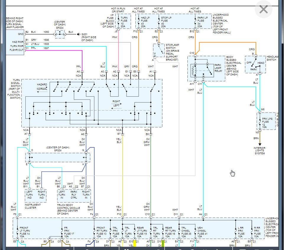

my brake lights are not working. I was told to check turn signals and hazards light. Now they are not working. Checked all fuses both locations all ok.

is the third brake light working?
Jul 28, 2021 at 6:34 AM
B J
yes, also turn and hazzard lights work
BLACKOP555
  • 10,386 POSTS
when that happens its a common thing that the turn signal switch has failed. the brake lights are tied into it and thy it works. turn the third one bypasses it which is why it works.
B J
thanks that fixed it.

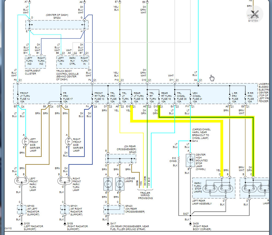

Just so that we have some documentation to go with this in case others have this issue, here is a guide that will help with how to figure this out:
Also, below is the wiring diagram that you will need to find the specific circuits needed to determine if the switch is the issue. Basically you need to test voltage coming out of the switch at the fuses.
