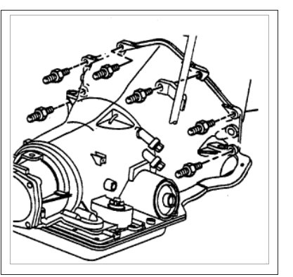

How do i get to the top two bolts on the transmission to remove it?

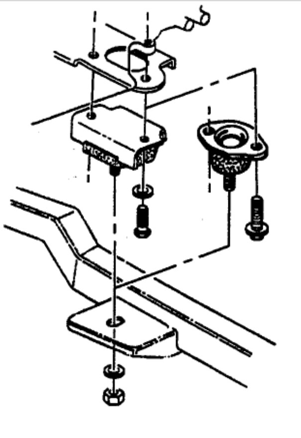

You use a long extension and go up from behind once the transmission mount is loose is here is a video of the job being done. Its a stick transmission but it shows what you what to see.
