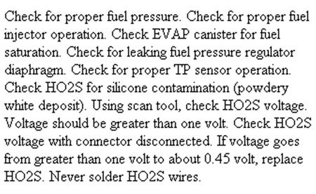

Bank 1 sensor three is the sensor behind the converter. Additional info:
https://images.2carpros.com/forum/automotive_pictures/30961_po144_1.jpg

[quote:b987b110a0="goboleko"]Thanks for the info on the O2 sensor.
The first thing you mentioned was checking fuel pressure, which reminded me that my fuel pumphas started getting noisy. When the truck is running, I can hear the whine of the fuel pump. I suspect it is about to take a dump do to the noise.
In your opinion, should I go ahead and drop the tank and replace the pump? I figure it's going to crap out on me in the near future anyway, so I'll replace it, have the warning light reset and see what happens.
Any advice on dropping the tank?
Sincere Thanks,
Jason[/quote:b987b110a0]
Noisy pump is often a sign of the pump on it way out.
Tips...Have plenty of time to work.
Replace the filter at the same time. If you are in any are where corrosion is a problem, this may be a rough job to do on the ground. You may run into problems with the straps. The tank, lines and sending unit may need replacement as you get into the project.
Use a delco pump.
Make sure you have plenty of room to work with to get the tank out.
To release the tank filler neck from the tank, use a haose separator used for radiators to break the seal on it , looks like a bent up screwdriver with a point on it.
