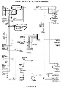

1997 Chevy Blazer 6 cyl Automatic 147k miles
Headlights are dim although replaced with new set, high beam indicator will not cut off yet they are not on and will not cut on, cannot find fuse box.

Hello mrswisha76541 Welcome to 2carpros.com Either the light green wire from the high beam indicator is shorted to power or the beam select switch is shorted. The wire may be rubbing and may have chaffed away some of its insulation can make contact causing a short to power, so wiggling that wire could reveal the problem. If the problem is not with the wire, the switch is shorted. (check your email for this diagram)
https://images.2carpros.com/forum/automotive_pictures/46384_0900c1528008f3eb_1.jpg
