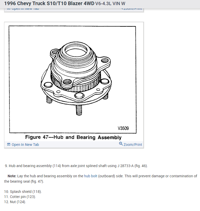

I have a rumbling noise as I drive, I believe it may be a bearing but, I'm not sure?

Any time you hear this type of noise, it is important to figure out from the noise is coming from. This can help determining what is the cause of it. Please note that a rumbling nose can be from tires as well as bearings.
If you figure out which wheel the noise is coming from, inspect the tire for any flat spots.
https://www.2carpros.com/articles/how-car-tires-work
Jack up that side and secure with jack stand. Turn the wheel. If you can hear any type of grinding noise then it is likely the bearing.
https://youtu.be/CQTfR7qiUMA

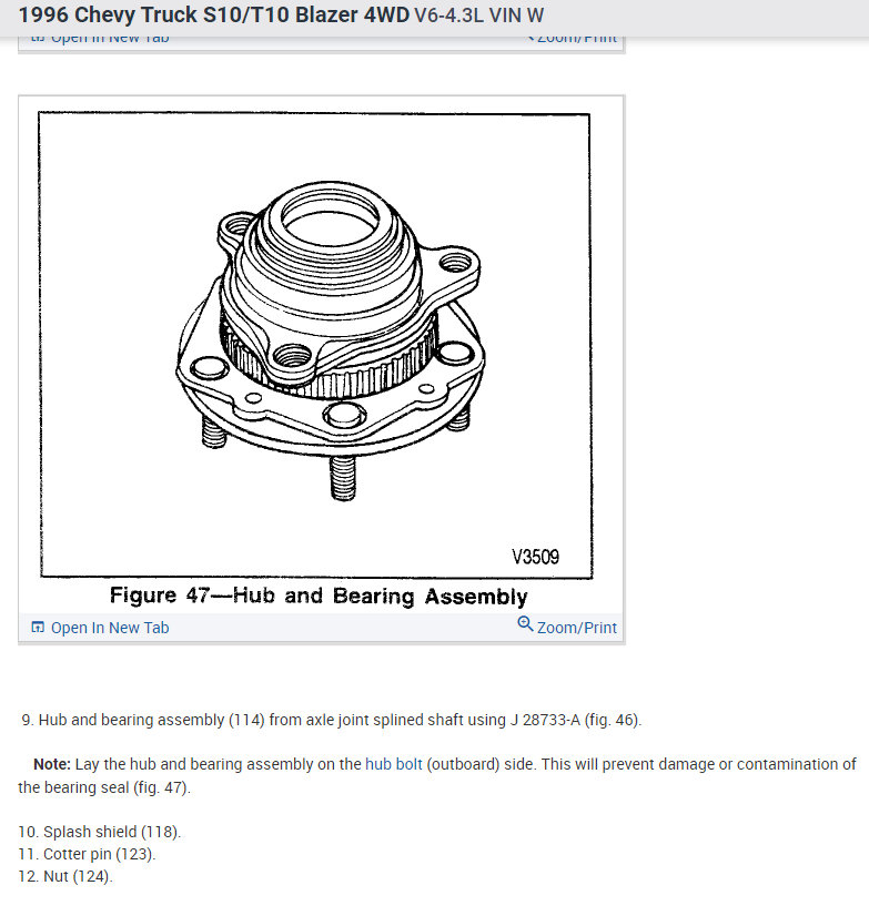

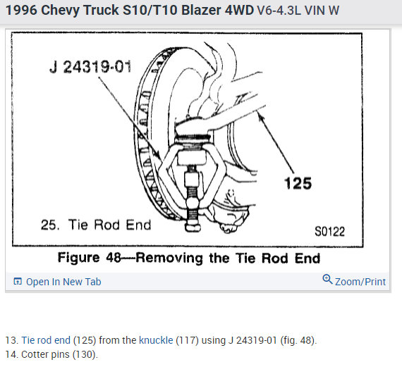

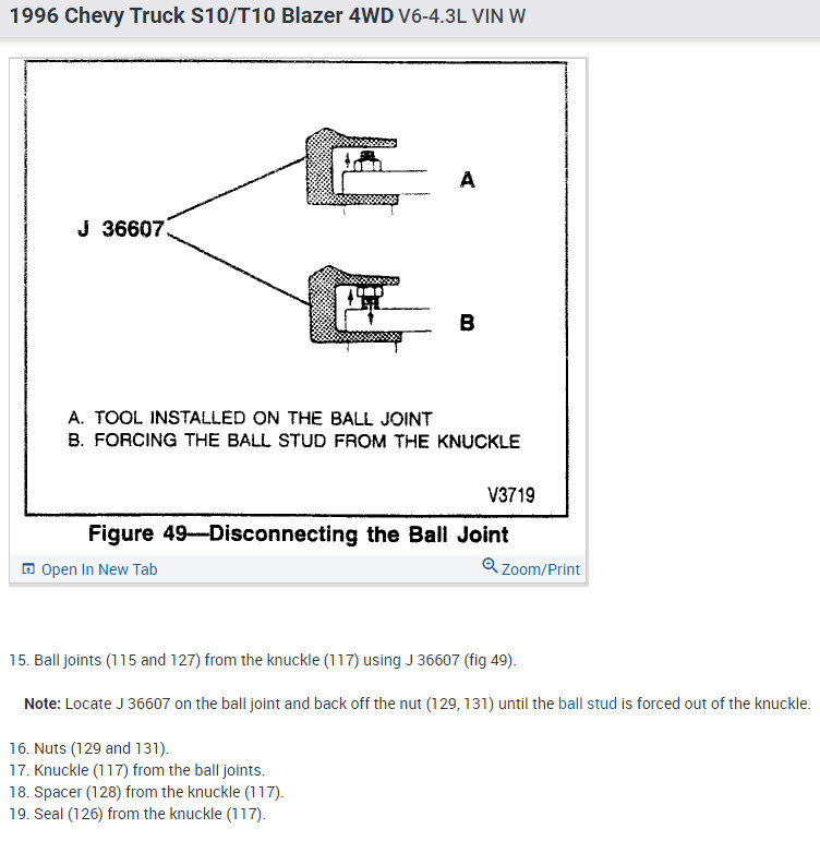

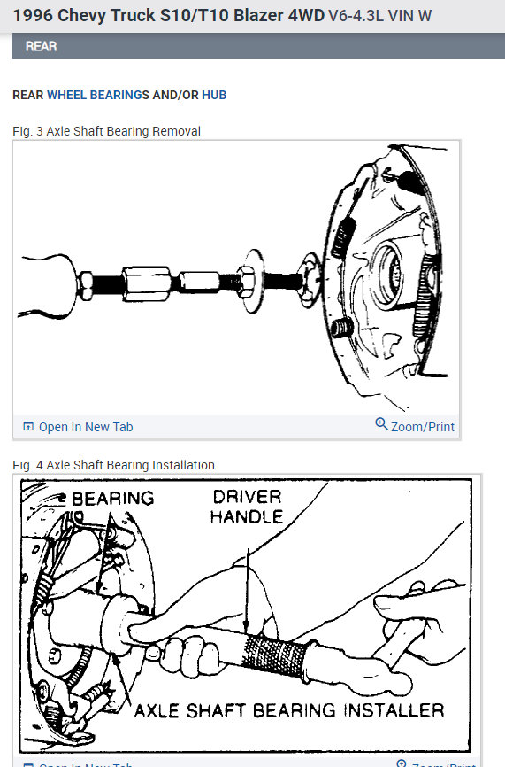

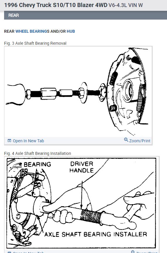

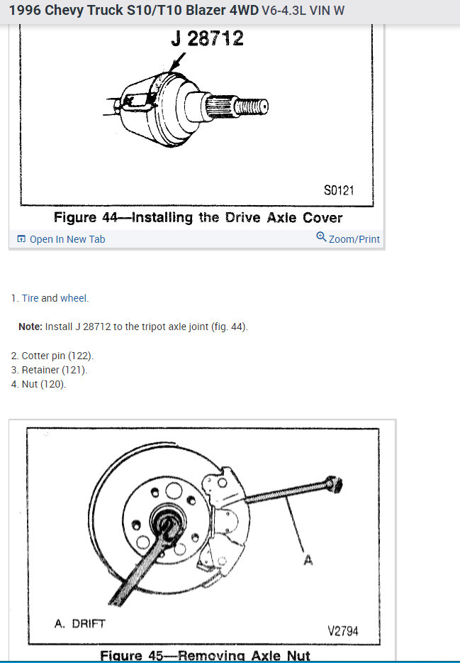

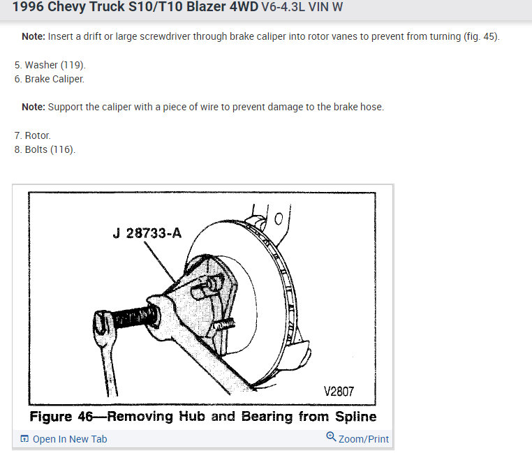

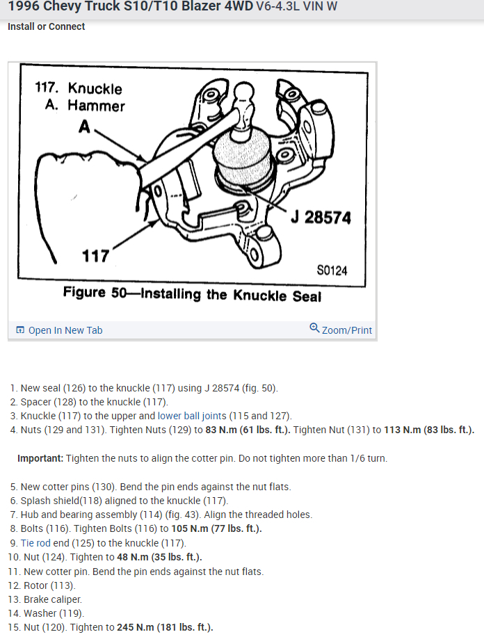

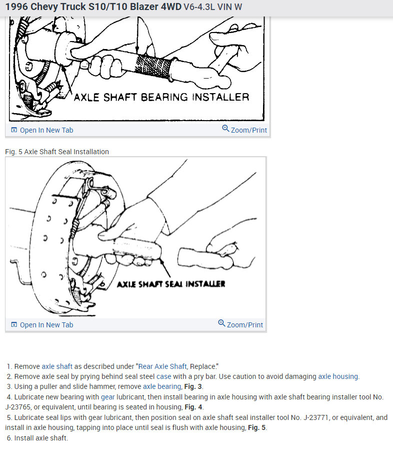

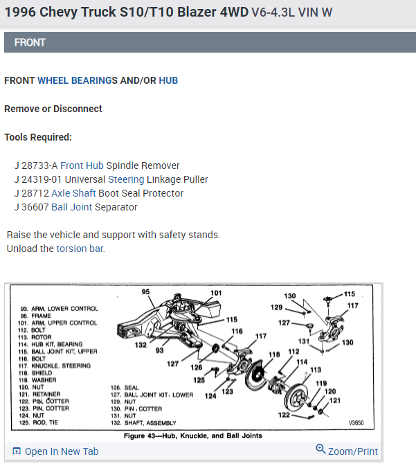

I have attached the replacement diagrams for your reference.
