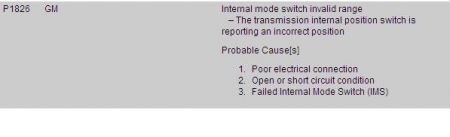

Hello, I need the actual code number. Are there any driveability issues?
I found the above info, if that is the correct code.
