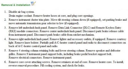

whats the best way to remove and install the heating core
Sep 16, 2009 at 9:08 AM
BLUELIGHTNIN6
Experienced Mechanic
16,542 POSTS
Hello and thanks for the donation! Below are the proper replacement procedures for your vehicle's heater core..
Will take a few hours labor time for an experienced mechanic to make this repair.
