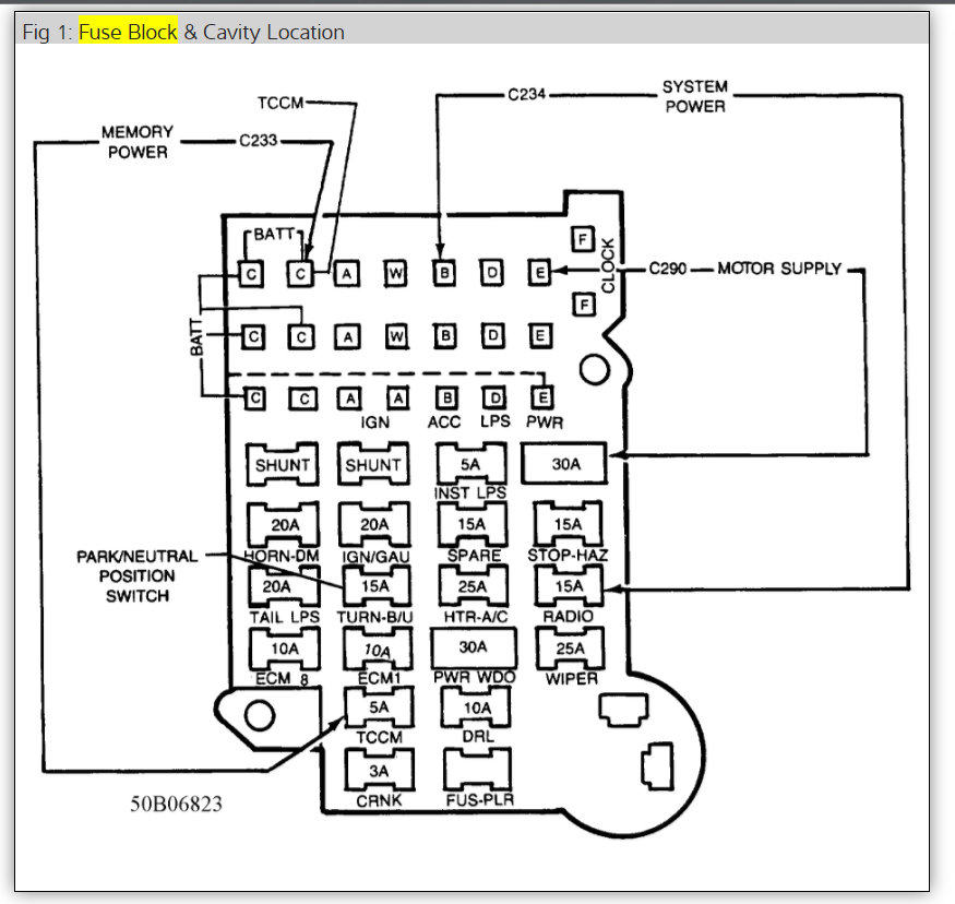

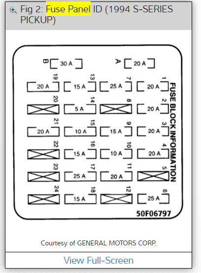

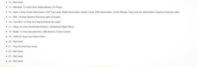

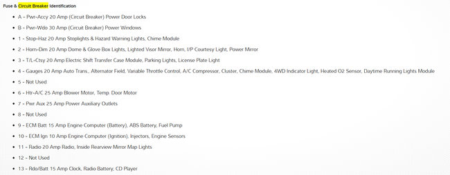

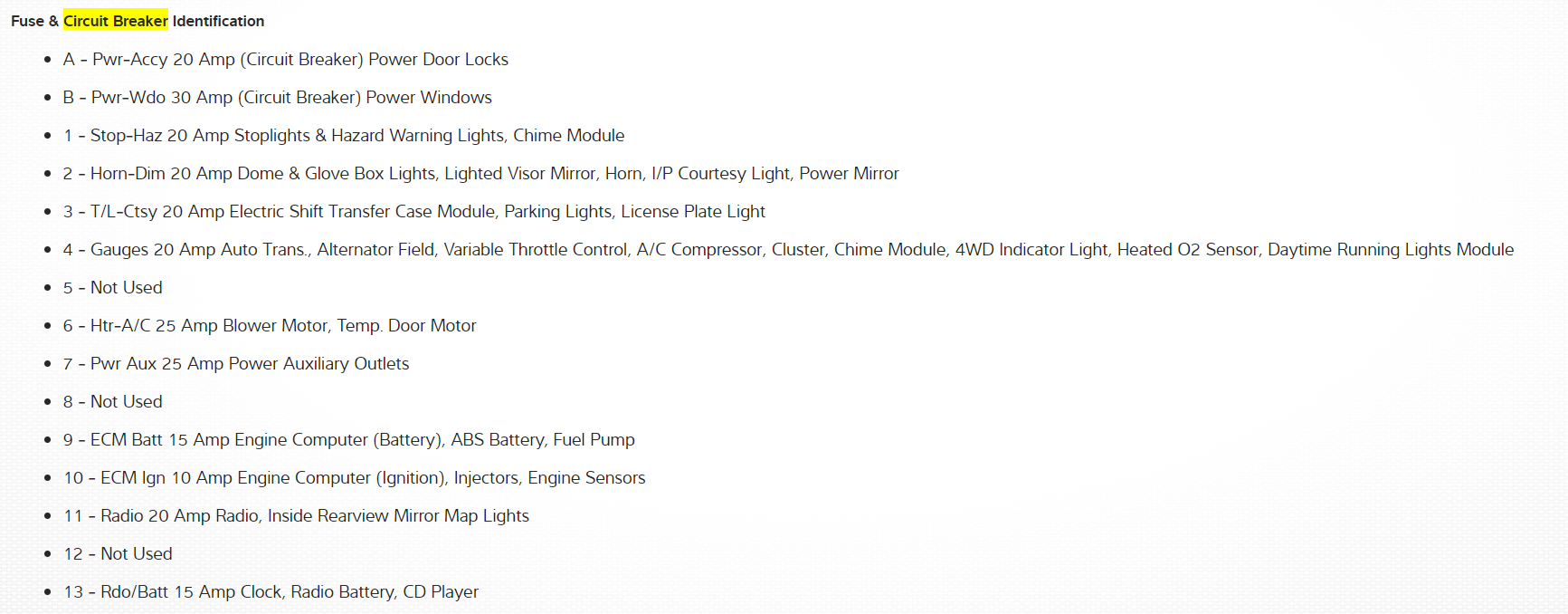

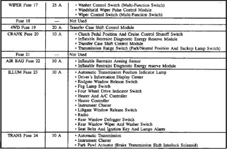

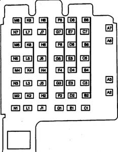

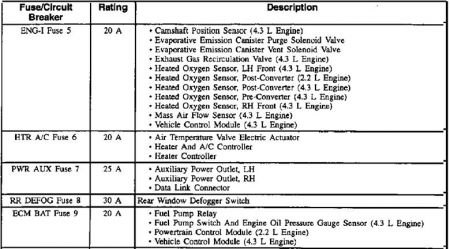

locate fuses that operate items? I need the fuse panel diagrams please

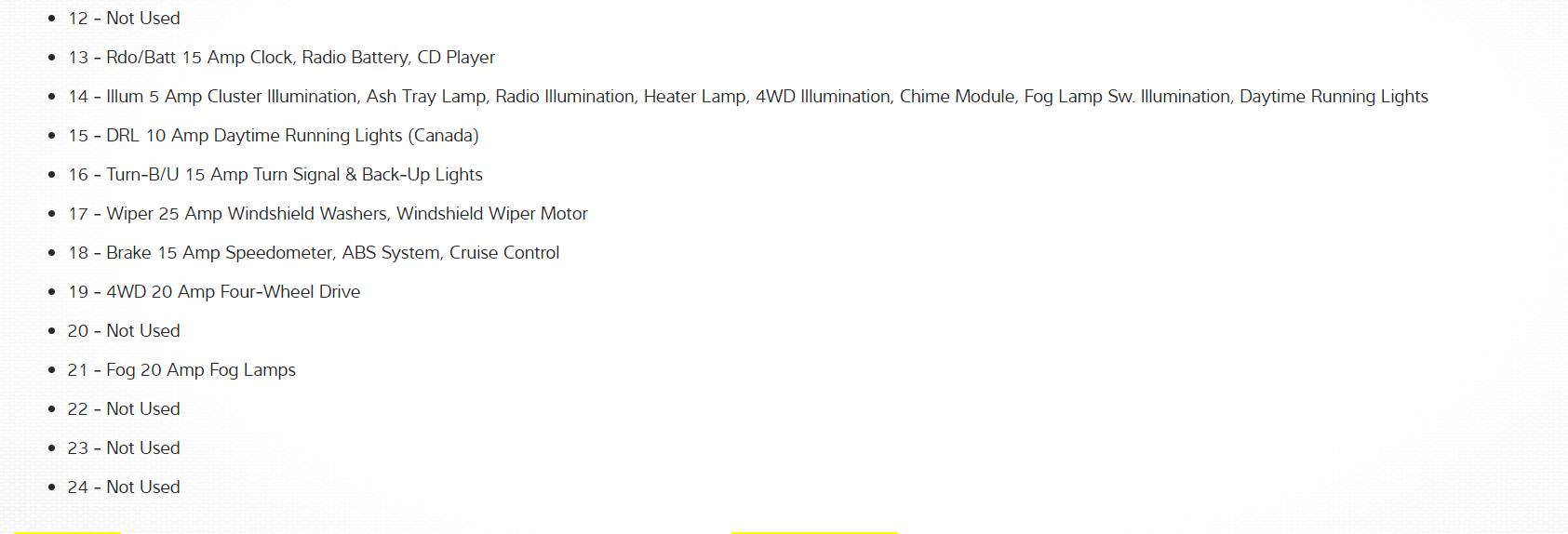

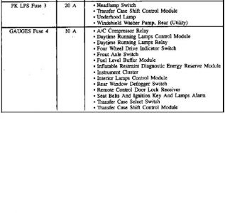

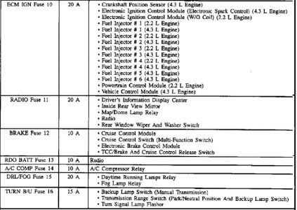

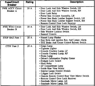

Hello, Here is a guide to help check them with the fuse panel diagrams below https://www.2carpros.com/articles/how-to-check-a-car-fuse

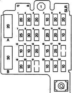

Need a fuse box diagram to know where to put what fuses. Thanks.

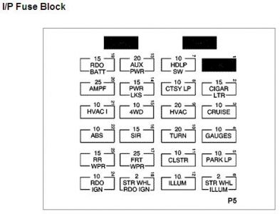

https://images.2carpros.com/forum/automotive_pictures/170934_ip_fuse_block_1.jpg
I found that in a database, you need to double-check, sometimes the databases are not correct. With a fuse removed, you can do a continuity test, from the dead leg of the fuse to whatever the fuse serves. Or you can plug and unplug the cigar fuse, whatever, see if it works.
