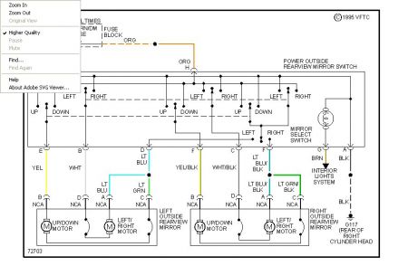

Hello: My power mirrors do not work. Can you supply me with a electrical drawing, and a switch pin out for the power mirrors?
Thank You
Oct 2, 2010 at 8:30 AM
HMAC300
Experienced Mechanic
48,601 POSTS
first check your fuses and make sure your swithc is in the correct position. Here is your schematic......
