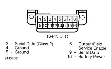

I bought an obd 2 code reader. Tried it on 2 blazers. Worked fine on 1. The second said no supported system. What reasons would cause this?

Your OBD-II reader will only work on '96 and later GM models, and very few '95 models, even if they have the OBD-II 16 pin connector
https://www.2carpros.com/forum/automotive_pictures/55316_obdii_1.jpg
as stated by the unit "no supported system". You will need a unit capable of OBD system (12 pin connector).
https://www.2carpros.com/forum/automotive_pictures/55316_obd_1.jpg
