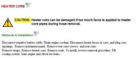

how hard is it to change the heator core in this blazer I have been told you have to remove the dash and all to get to it and is there a web site that could give me a break down on this

https://www.2carpros.com/forum/automotive_pictures/261618_Noname_1757.jpg
https://www.2carpros.com/forum/automotive_pictures/261618_Noname2_552.jpg
