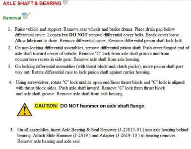

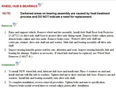

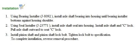

how to put wheel bearing in the axles and how to get the bearing on
May 14, 2010 at 5:11 PM
BLUELIGHTNIN6
  • 16,542 POSTS
https://images.2carpros.com/forum/automotive_pictures/261618_Noname_2164.jpg
May 14, 2010 at 5:17 PM
NEWPORT38
how to chance the wheel axis bearing on a 1995 chevy blazer rearend
