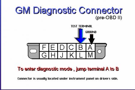

1995 Chevy Blazer Four Wheel Drive
I can smell a sulphar smell I thought it was the converter and got it changed but I still smell it and it surges
Sep 12, 2009 at 8:27 AM
MERLIN2021
  • 17,250 POSTS
You are running too rich, either an 02 sensor, MAF sensor or stuck innjector, but if the service engine light is on lets read the codes as a first step, here's how: Cross these two terminals as shown with a piece of wire, then turn the key on. Count the flashes, a 22 will flash as 2 flashes then a short pause, then 2 flashes, if more than one code is stored, the pause will be longer. The codes will display three times and end with 12. Write them down and post here. This connector is right under the middle of the dash...
