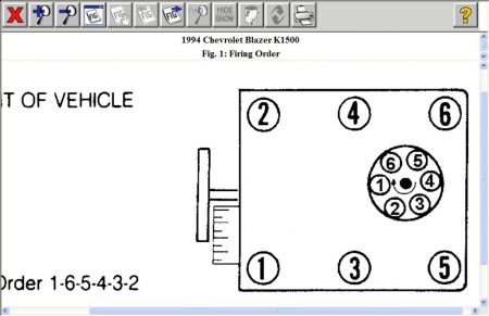

I need the wiring diagram for the distributor cap. I crossed some plug wires and i need to get this car done and back to my sister but this is my only problem. Please send this to me as fast as you can if its not too much trouble. Thank you so much.

See below
https://images.2carpros.com/forum/automotive_pictures/12900_fo_71.jpg
