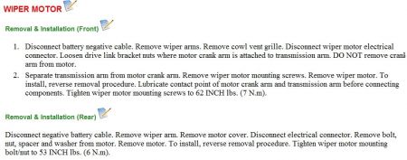

I need instructions to replace the windshield wiper motor

https://images.2carpros.com/forum/automotive_pictures/261618_Noname_2794.jpg
