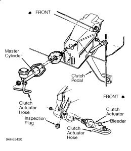

I went to put in reverse it made an awful noise
1994 CHEVROLET BLAZER
SNYDMD111607
My blazer was driving fine last night and then this morning i went to leave for school and it started but when i went to put in reverse it made an awful noise and wouldn't go. so i then tried putting it into 1st and it wouldn't go into any gears but it only made the noise when i tried to put it in reverse. my dad said i need to adjust the clutch. any ideas on how to do so? oh and when i turned the truck off i could put it in 1st again.
Mar 9, 2010 at 8:09 AM
DOCFIXIT
  • 18,828 POSTS
Clutch is hydraulic operated. Check to see if fluid is full oin master also at slave check for leaks.
https://images.2carpros.com/forum/automotive_pictures/198357_Graphic_381.jpg
