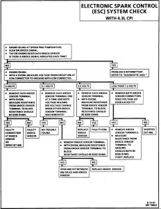

How do you test the ESC Module and the Knock sensor?

My experience with a no spark problem has been that the ESC Mod is usually the bad part.
Save pic then you can enlarge to view....
