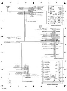

Can u help with the following
1. I do not get a check eng light at all. A code reader shows signal when plugged in. Hate to have to pull dash apart. What is wire color from ECM for the light? I may just put a external light.
2. When I put the timing chain cover on I made sure the dots on the cam and crank gears were aligned properly. Then when I put the dampener on neither of the two factory marks aligned with scale. If I recall I think the second one should be used. At any rate I just put a mark on the dampener at the 0 degree indicator. My mark is to the right of the two factory lines. After the engine was warm I shut off, unplugged the wire under the glove box and adjusted my timing to 0 degrees using my mark. After hooking the wire back up it seem to run ok.
Does this sound ok?

Yes this sound right it sounds like you put everything back as it should be great job. As for the wire color here a wiring diagram of the instrument cluster and the engine light diagram is on it hope this helps. Let me know how it goes ok. You may need to save pic and then make it bigger so you pan it and be able to read it too. ok.
