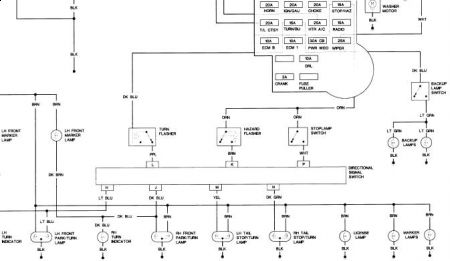

1989 Chevy Blazer turn signals
105,000 MILES • 6 CYL • 2WD • AUTOMATIC
J.SKELLINGTON
thanks for your time, i really appreciate this.
it seems that my turn signals dont want to work anymore for some reason. my hazards work, but when i try and use the turn signals i get nothing. i know this is probably a minor fix and i'm probably dumb for not figuring it out, but I thought I'd ask ya'll for help.
Thanks again

https://images.2carpros.com/forum/automotive_pictures/170934_89_s10_blazer_1.jpg
Not sure that is readable, maybe you can see the wiring colors? Did you check the turn fuse in the fuse box? Use a testlite, check for voltage at the fuse circuit as well as a bad fuse. The purple wire carries voltage from turn flasher to turn signal switch. There is probably a multiwire connector under dash, close to steering column, for the circuits going to and from the steering column. You can use a testlite and check the proper circuits for voltage at the connector.
