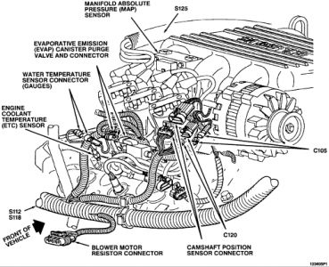

Where is it located, is there a way to check it. Car runs fine for about a mile then starts cutting out under a load. Will accelerate with no problem and idles fine. One mechanic said it sounds like MAP sensor
does this sound right.

https://images.2carpros.com/forum/automotive_pictures/12900_map_18.jpg
Testing it go here: http://www.wonderhowto.com/how-to-test-and-replace-m-a-p-vacuum-sensor-circuit-251789/
