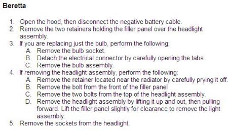

1995 Chevy Beretta Manual 161570 miles
yes,I am just trying to find out how I go about taking the old bulbs out and put these new ones in.
Feb 18, 2010 at 3:40 AM
JDL
  • 16,098 POSTS
Welcome to the forum. I found this info.
https://images.2carpros.com/forum/automotive_pictures/170934_beretta_1.jpg
