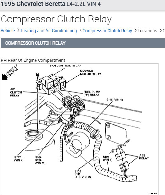

when i turn on my front defrosters my windows get all fogged up and i cannot see.the heat comes out of the vents so i know the fan works.i smelled what i thought was antifreeze when i turned them on so i check it was low so i filled it up but everything still fogs up

This issue is likely caused by inoperative A/C compressor.
When the defroster gets turned on the A/C kicks in to dehumidify the air, this helps to evaporate moisture from the windshield.
So, check to see if the A/C is coming on. Sometimes the A/C compressor will not turn on due to being low on Freon. It can also have a bad relay for the clutch.
The relay is located under the hood (see diagram).
Check the relay for any corrosion or burnt pins.
Here is a procedure on how to test the relay:
