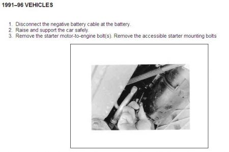

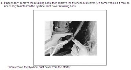

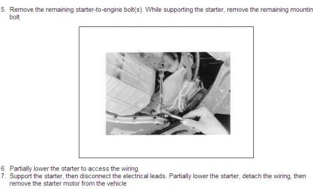

1994 Chevy Beretta 6 cyl Two Wheel Drive Automatic
How do you replace the starter? Where are the bolts located?
Apr 10, 2009 at 5:30 AM
JDL
  • 16,098 POSTS
[img]https://images.2carpros.com/forum/automotive_pictures/170934_beretta_starter_1.jpg[/img
https://images.2carpros.com/forum/automotive_pictures/170934_beretta_1_1.jpg
https://images.2carpros.com/forum/automotive_pictures/170934_beretta_11_1.jpg
https://images.2carpros.com/forum/automotive_pictures/170934_beretta_123_1.jpg
