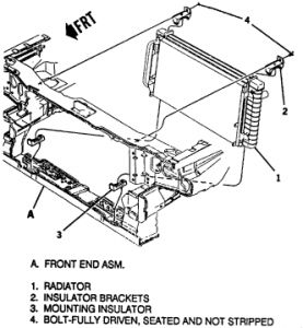

How do you replace the radiator in a 1994 chevy beretta.
Jan 16, 2010 at 6:44 AM
  • 75,992 POSTS
Radiator Mounting
https://images.2carpros.com/forum/automotive_pictures/12900_radiator_2.jpg
REMOVE OR DISCONNECT 1.Battery. 2.Drain the cooling system. 3.Air intake duct assembly. 4.Upper radiator hose. 5.Upper and Lower transaxle cooler lines. 6.Cooling fan. 7.Splash guard and lower radiator hose. 8.Condenser line retaining clip and condenser to radiator bolts (If equipped with A/C). 9.Coolant surge tank hose. 10.Radiator retaining bolts and radiator. INSTALL OR CONNECT 1.Radiator and retaining bolts. Tighten bolts to10 Nm (89 lbs in) . 2.Coolant surge tank hose. 3.Condenser to radiator bolts and condenser line retaining clip. (If equipped with A/C) 4.Lower radiator hose and splash guard. 5.Cooling fan. 6.Lower and upper transaxle cooler lines. 7.Upper radiator hose. 8.Air intake duct assembly. 9.Fill cooling system. 10.Battery. 11.Inspect for leaks and cooling fan operation.
