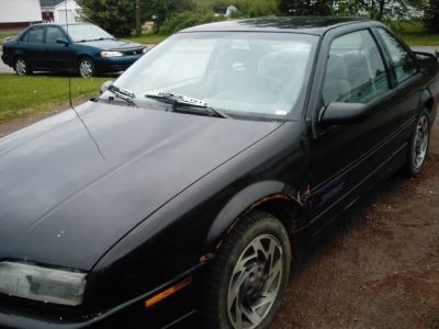

I have a 1994 Beretta and when it rains the floor of the car becomes wet and I can't find the leak. I have had to remove the insulation under the carpet and drill a small hole in the floor to drain the water. The seal around the windows are good and there are no visable holes or rust spots.
The car is not being driven at the moment.
Please can anybody help me solve this problem before it gets any worse. Also my brothers 1992 Beretta does the same thing... but his is more to the back of the car while mine is in the front...[img:84d1a95579]http://www.2carpros.com/forum/automotive_pictures/355283_n784370314_3664432_1723_2.jpg[/img:84d1a95579]

Hello, if you can get access to service bulletin 53-10-21, it will give you some ideas. I tried to post a link to the bulletin, it didn't work. A lot of libraries carry the database I was looking at. The info is free if they service your area.

Ok, in the box for the card number type 12 then hit submit, scroll down to muskingum county, hit submit, scroll down the page to autorepair reference center, click there. It will ask year make and model, just follow the links. You will get to a link about service bulletins, scroll down the page to the link about bodies. If anybody asks, you didn't get that info from me. If your local library carries this database, it's free.

Thank you so much. I was able to print off the Service Bulletin and hopefully the answer is in there.
It is funny I can't find no info like that in Canada...
Thanks again and have a great day!!!!
