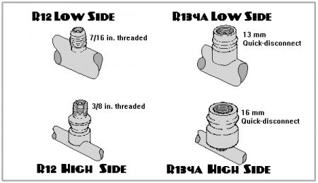

im not sure where to put the free-on. can you help please? ive been to two different places and they both say different things. i live in miami florida and it is extremely hot.

You're looking for the 13mm fitting which is the low side located between the compressor and the evaporator-keep looking you'll find it
https://images.2carpros.com/forum/automotive_pictures/12900_ac_service_fittings_37.jpg
