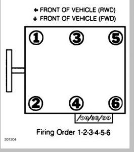

1992 Chevy Beretta fireing order of the coil paks
TEEPANATOR
Engine Mechanical problem
1992 Chevy Beretta 6 cyl Front Wheel Drive Automatic
the coil paks are in the front on engine need to know the fire order from left to right not sure but i think its 146325
Nov 25, 2009 at 6:25 AM
JDL
  • 16,098 POSTS
https://images.2carpros.com/forum/automotive_pictures/170934_31_beretta_1.jpg
My info showed the above for the 3.1
