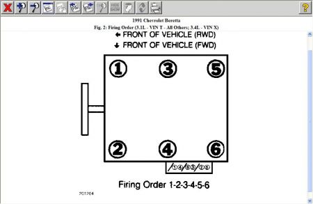

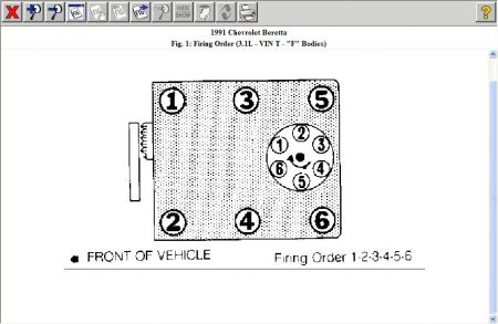

I HAVE A 3.1 ENGINE, IN WHAT FIRING ORDER ARE THE SPARK PLUG WIRES PUT ON BY NUMERICAL NUMBERS ?

Pick your own 3.1L
https://images.2carpros.com/forum/automotive_pictures/12900_fo1_3.jpg
https://images.2carpros.com/forum/automotive_pictures/12900_fo2_3.jpg
HTH-Good Luck
