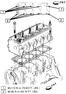

Engine Mechanical problem
1988 Chevy Beretta 4 cyl Front Wheel Drive Automatic
need info on head bolt patterns and torq specs.

Hello. Using a torque wrench, tighten the bolts as follows: tighten the long bolts to 73-83 ft lbs. (11 Nm), in the sequence shown in the illustration and tighten the short bolts to 62-70 ft lbs. (84-95 Nm) in the sequence shown in the illustration.
https://images.2carpros.com/forum/automotive_pictures/261618_0900c152800a7227_1.jpg
NOTE: The short bolts, exhaust side, should end up with a total rotation of 100 ° and the long bolts, intake side, should end up with a total rotation of 110 °.
