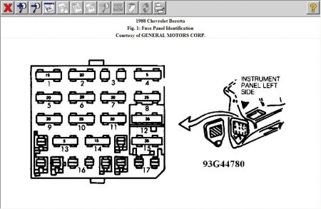

new battery and alternator and battery keep going dead,is there a altenator relay or fusable link,if so where are they located,can't even find the fuse box on this car?

Disconnect the positive battery cable put a test light between the disconnect cable and battery positive post-if the test light lits-you have a short start removing fuses one by one the one that turns off the test light is the trouble circuit.
Dec 3, 2007 at 1:17 PM
  • 75,992 POSTS
See below
https://images.2carpros.com/forum/automotive_pictures/12900_fuse_panel_1.jpg
