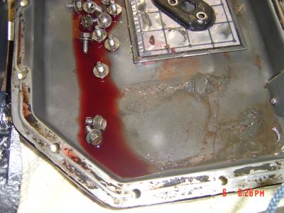

Thanks for the info....No there was not a gasket between the filter and the valve body, it was just held in place by 2 machine screws. SHould there be a small gasket there, It looks like the one in the oictue so I guess that is the gasket.? I feel the same way you do the damage has already been done without the filter in place, and for how long is wasn't no one knows. I think I'll take your advise and have the pressure checked at a transmission shop. It is really a PITA to change out an automatic unless you have a good jack and an extra person to help. I did notice some felt stuff in the pan, I failed to mention it. I'm going to try to attach a picture for you to see.

if you have some what you call felt it may be clutch pak material. But ya have apro look at this. What happens when a novice builds stuff like this they aren't real careful putting seals in and sometimes they roll instead of going in correctly, which allows slippage due to the clutch piston not being able to apply the clutch pak like it should. Plus they may not have changed the steel rings which i had stated in the last email and there are 3 or 4 on the back end of the oil pump assy which is for the torque converter and a couple on the input shaft. If these leak then it gives you problems. Plus if the filter was in the pan it's possible that junk got into the valve body or govenor, although there should be a screen to protect the govenor. On the filter it looks like it might be pieces of clutch material . at least from the picture. Remember it is hard to give a proper diagnosis on the computer here without seeing this. good luck with it.
