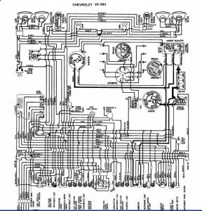

Electrical problem
1961 Chevy Bel Air V8 Two Wheel Drive Automatic n/a miles
Im trying to change over from a generator to an alternator and im having trouble getting my headlights and dashboard lights working is there a wiring diagram for the electic to make this changeover.thanks

The lights had run off a power lead , Summit and year one have one wire altinators that fit your chevy if you don't all ready have one. They eliminate the need for a voltage regulator Enclosing a diagram of wiring. If you can't read it save it as a jpeg and then you can enlarge it.
