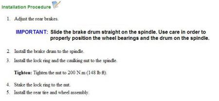

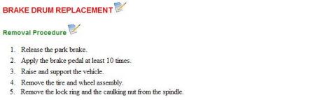

I have the new assembly and my daughter will be home from college this weekend. Is there anything I need to know about replacing this bearing, like is it PRESSED into the brake drum?
Feb 25, 2010 at 12:36 AM
BLUELIGHTNIN6
  • 16,542 POSTS
The rear wheel bearings are in the brake drum. You have to replace the wheel bearings / brake drum as an assembly only.
https://images.2carpros.com/forum/automotive_pictures/261618_Noname_1763.jpg
https://images.2carpros.com/forum/automotive_pictures/261618_Noname2_556.jpg
https://images.2carpros.com/forum/automotive_pictures/261618_Noname3_215.jpg
https://images.2carpros.com/forum/automotive_pictures/261618_Noname4_109.jpg
