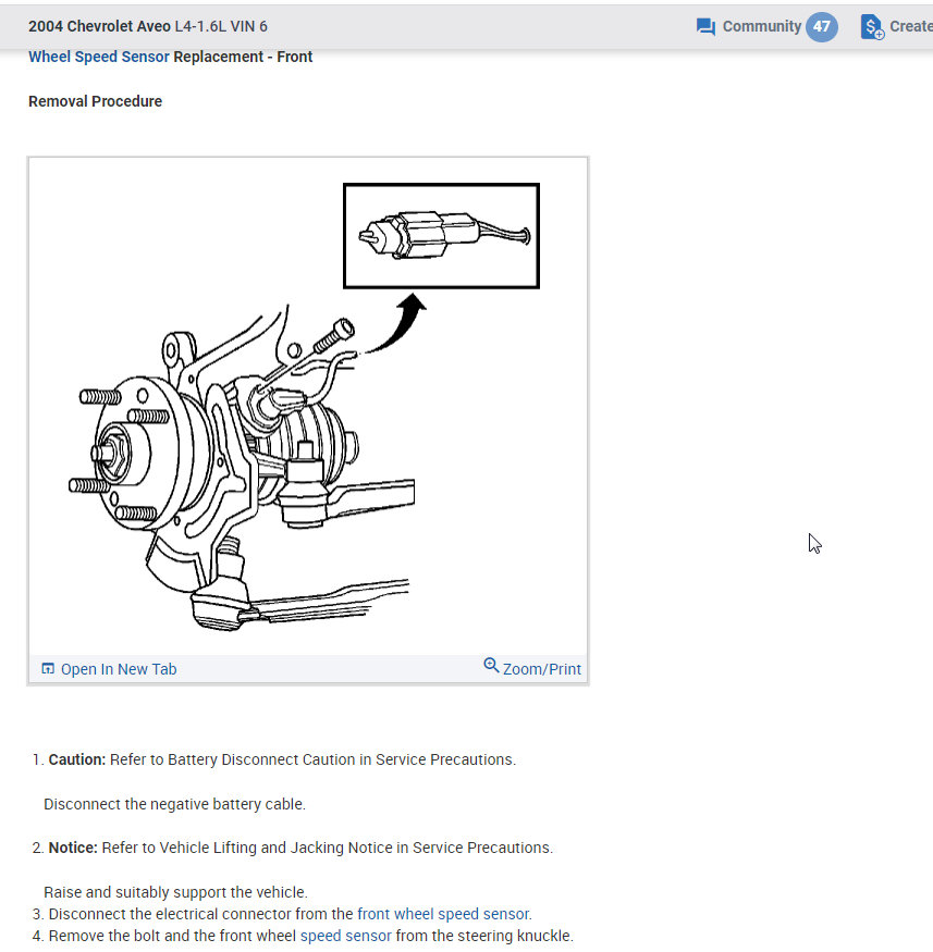

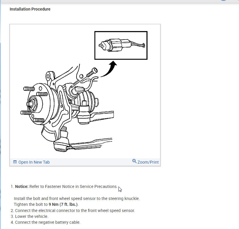

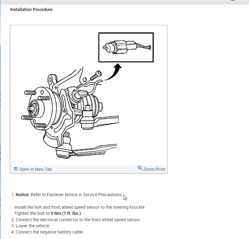

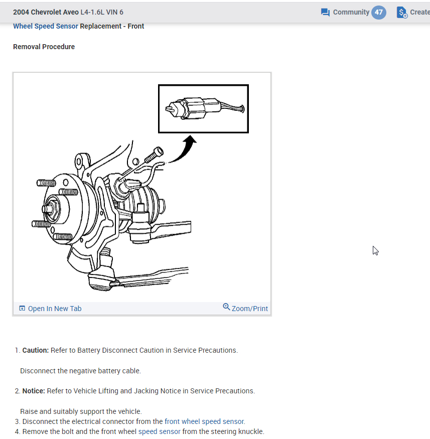

What happens if I change the ABS wheel sensor myself?
Monday, July 13th, 2009 AT 3:32 PM
MECHANIC
18,907 POSTS
If you replace it using the guides below then you should be able to replace it properly.
https://www.2carpros.com/articles/abs-wheel-speed-sensor-test
https://www.2carpros.com/articles/how-to-replace-an-abs-wheel-speed-sensor
I attached the info below on how to replace the sensors. Please let us know if you have other questions. Thanks
