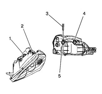

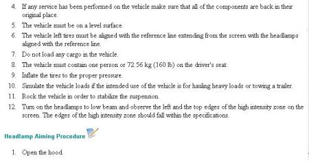

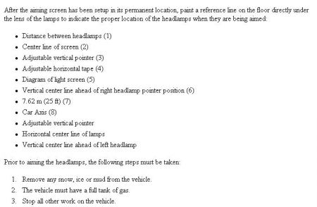

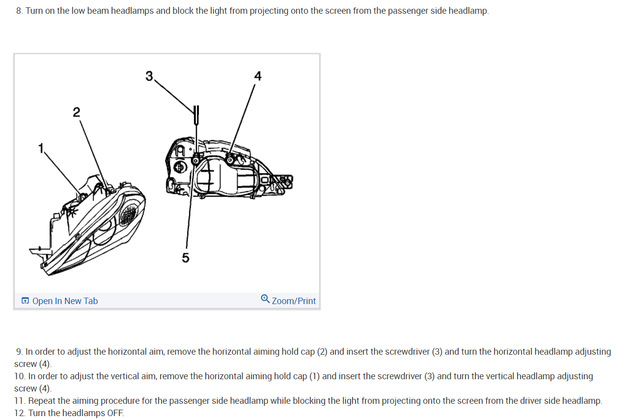

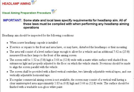

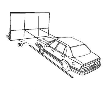

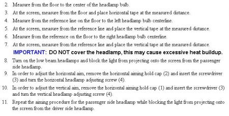

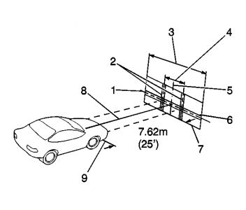

How do you aim the front headlights because mine is way off on it's aim distance.
Jan 5, 2009 at 8:01 AM
ZACKMAN
  • 4,202 POSTS
Here are the headlight adjust instruction with the diagrams below to show you where the adjusters screws are.
