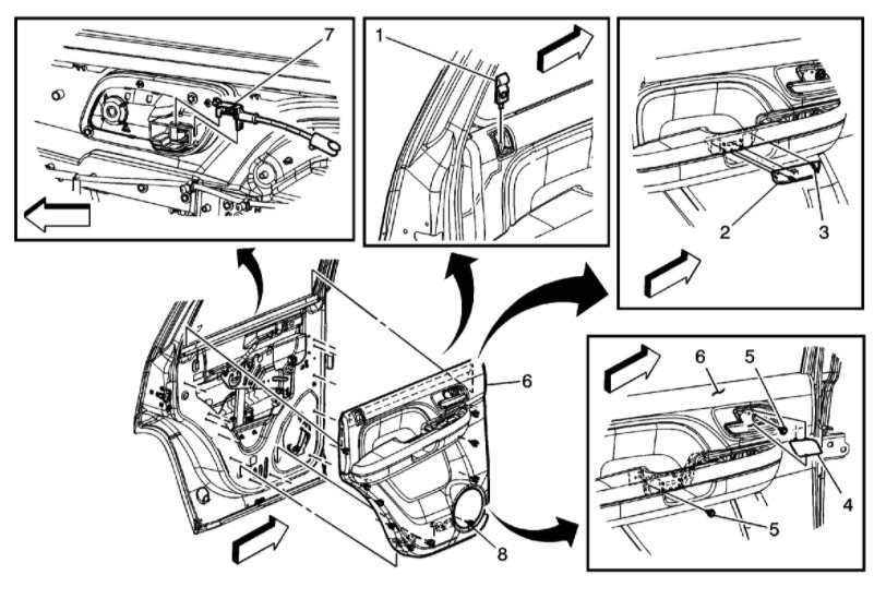

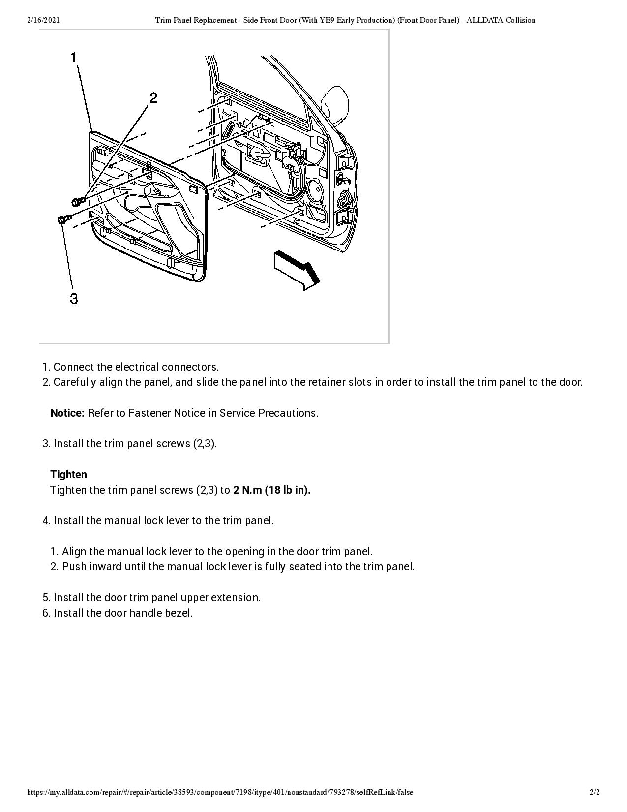

How do I remove the rear drivers side door panel?
Mar 18, 2010 at 2:29 PM
DANNY L
  • 5,648 POSTS
Hello, I'm Danny.

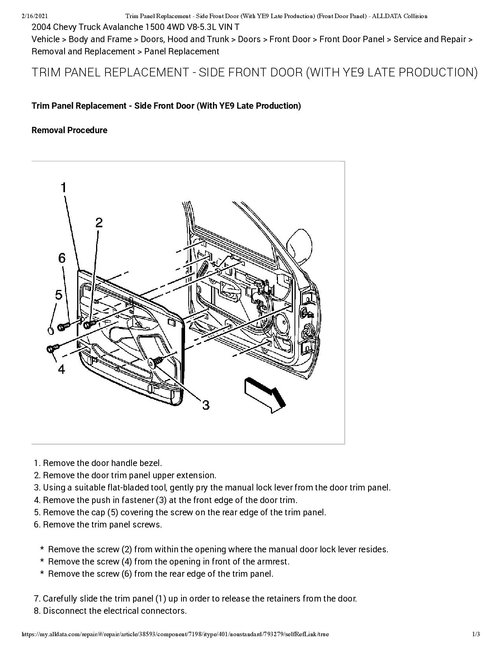

Here is the information you requested. Here is a tutorial on door panel removal to get you started:
https://www.2carpros.com/articles/door-panel-removal
I've attached picture steps below on how to remove and install the door panel on your truck. Hope this helps and thanks for using 2CarPros.

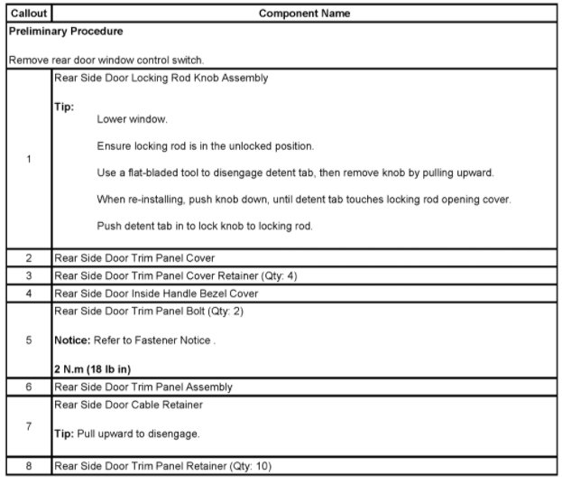

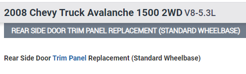

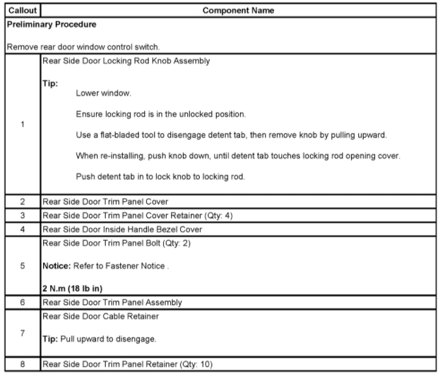

How do you remove the rear dorr panles (interior)? I hit a bump and the rear passenger door speaker doesnt work. I want to take the panel off to see if the speaker wires came undone.
Feb 19, 2021 at 1:05 PM (Merged)
  • 110,194 POSTS
HI: THIS IS THE BEST PICTURE i COULD FIND OF THE MOUNTS FOR THE PANEL
https://images.2carpros.com/forum/automotive_pictures/249084_doortrim_1.jpg
LET ME KNOW IF IT HELPS. JOE

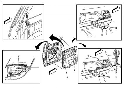

I am trying to replace the driver side mirror and need to remove the door panel. How do I do this on the truck listed above?
JOETECHPRO
  • 705 POSTS
Hey gmandr,
Thank you for your question.

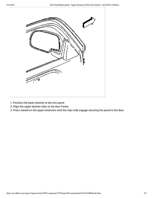

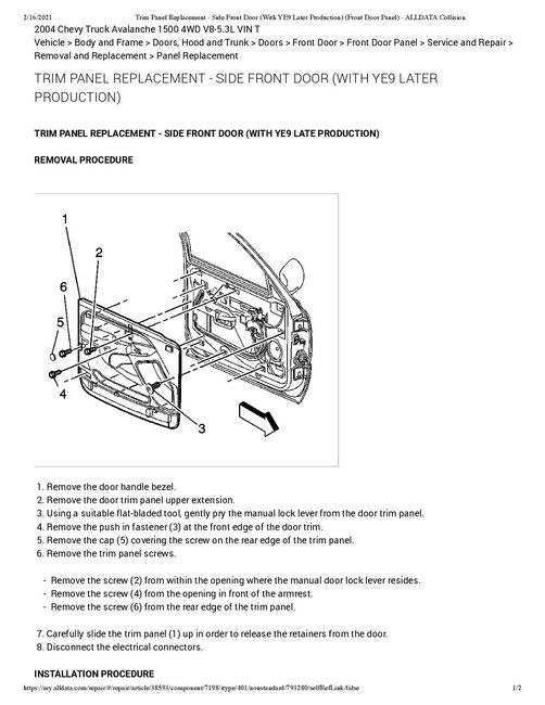

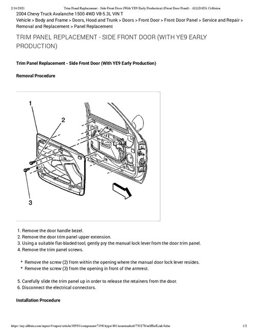

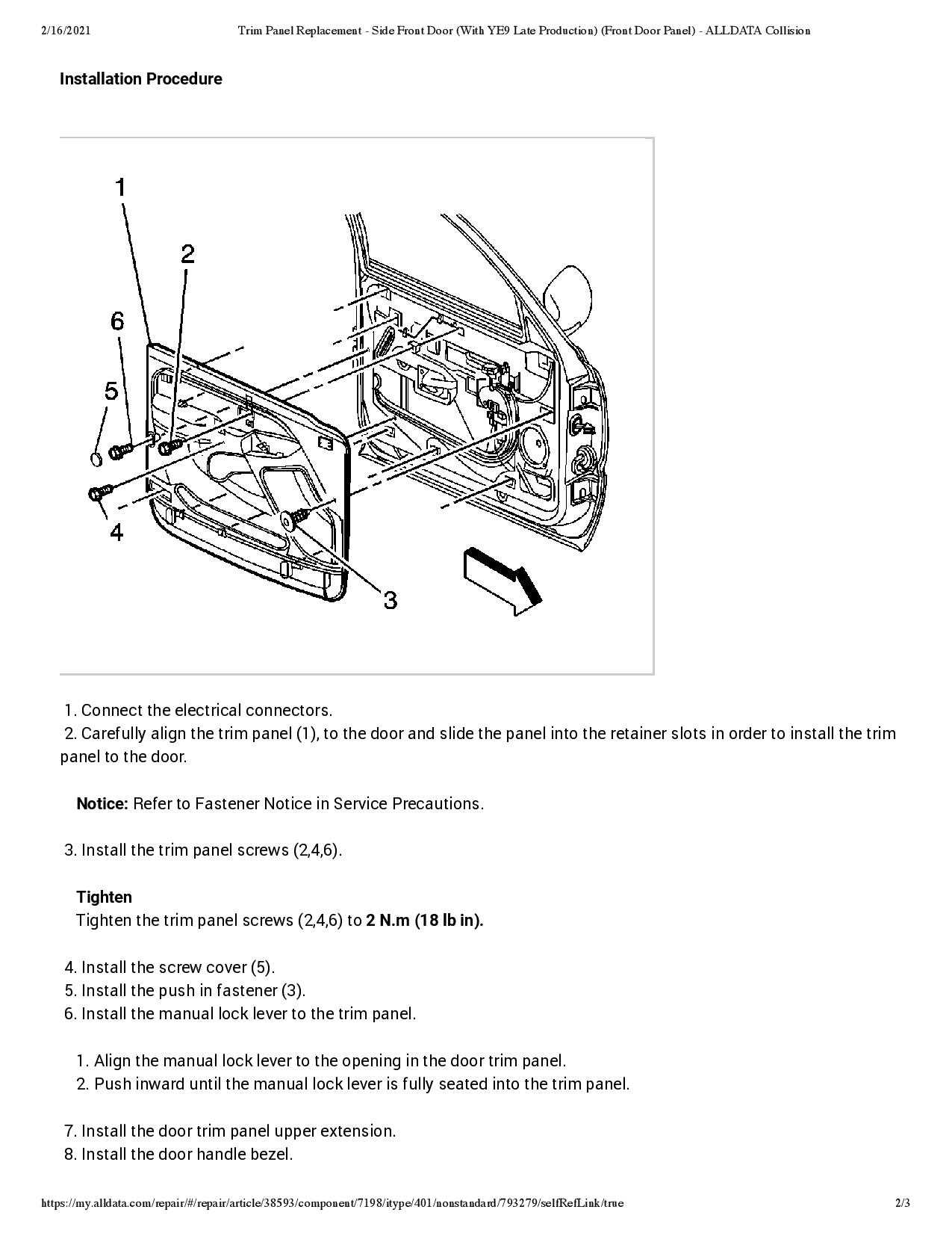

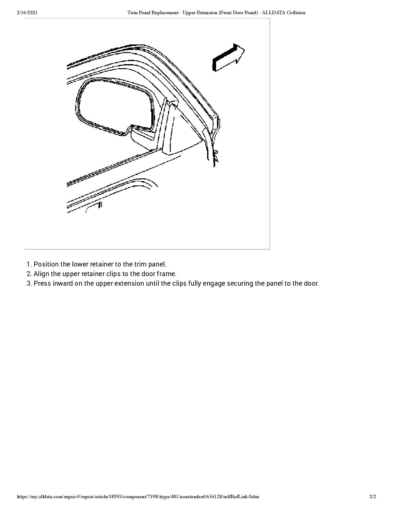

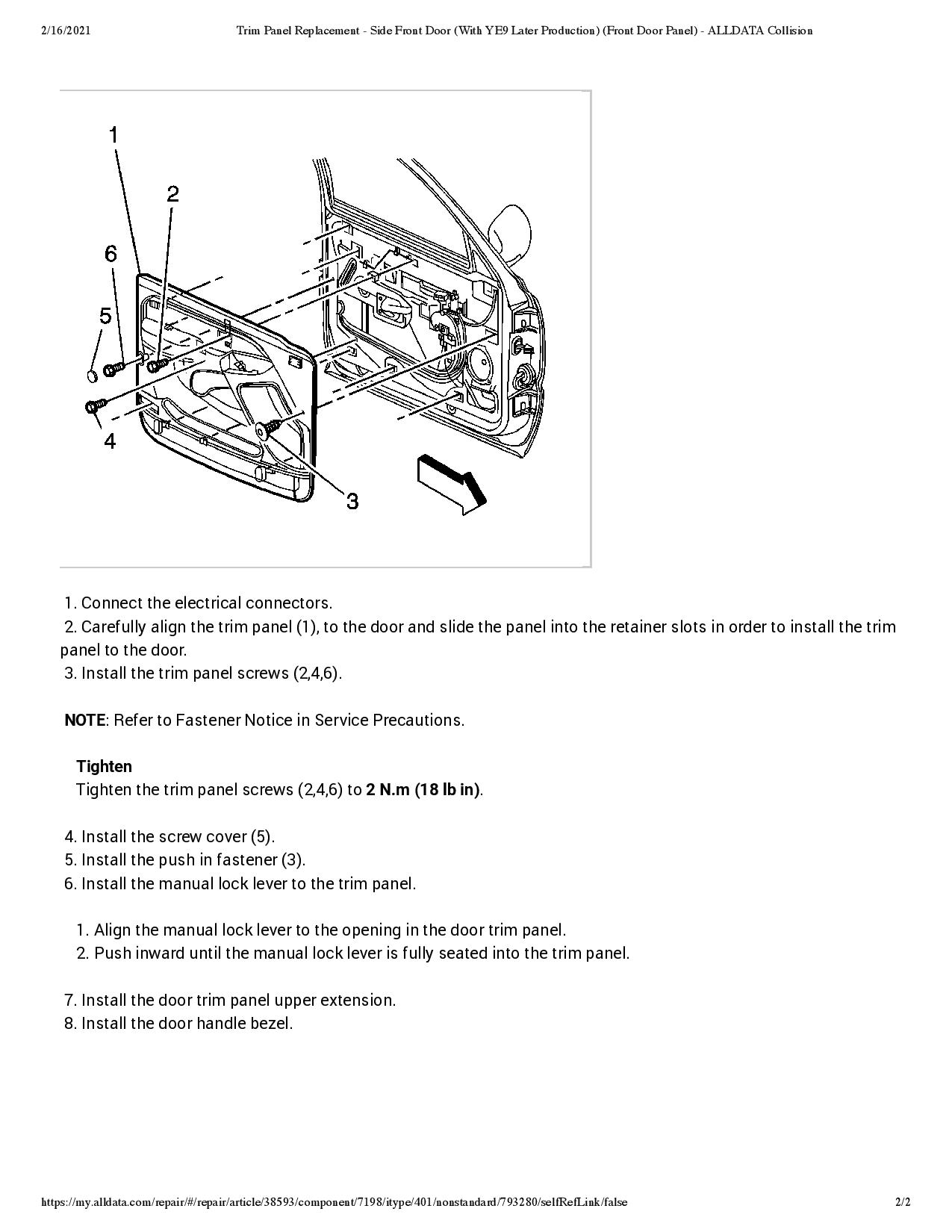

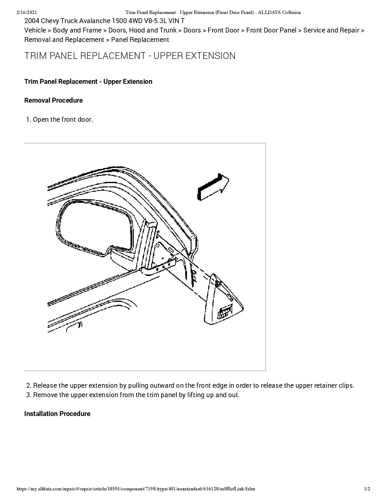

There are a couple of options for early and later production vehicles.
Below i have attached instructions to remove the interior trim (Door panel upper extension)
I have then attached the door panel instructions starting with early all the way through to the later production models.
Also for some useful general information regarding this repair be sure to check out the 2CarPros repair guide at:
Either way once the screws are removed the door panel should pull up to release from the door.
Hope this helps, let us know if you have any further questions. Check out the diagrams (Below). Regards, Joe

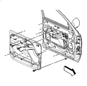

Need to have diagram of how to remove door panel to access motor window and troublshoot
Thanks
Feb 19, 2021 at 1:06 PM (Merged)
  • 110,194 POSTS
Here is a picture of the door trim and how it is mounted. Here it is.
https://images.2carpros.com/forum/automotive_pictures/249084_door_1.jpg
