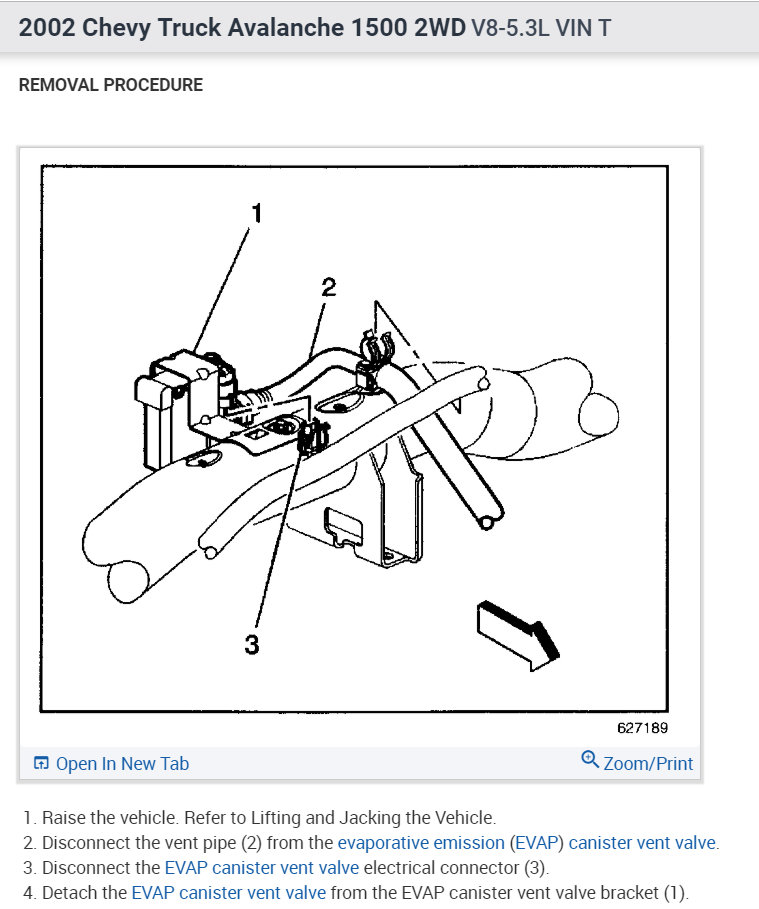

where is the location of my evap canister? for years i have seen them under the hood, but not on this model. i need to change out the purge solenoid that bolts to the canister.

the purge solenoid it mounted under the hood, here is the location in the diagrams below. Check out the diagrams (Below). Please let us know what happens.
