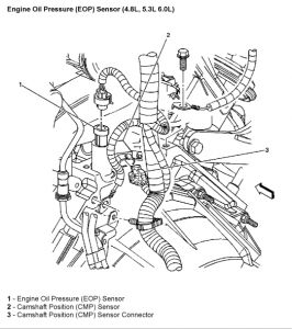

most of your answers to high oil pressure question say sender is down by oil filter , (misleading) I have same problem on my 2005 avalanche and sending unit is on top of engine block , driverside by firewall . good luck getting to it . I can probably get it out but I don't think I could get new one in .

https://images.2carpros.com/forum/automotive_pictures/12900_oil_pressure_sensor_7.jpg

It's located behind the oil filter. You may have to remove the sheid to acess the pressure sensor
