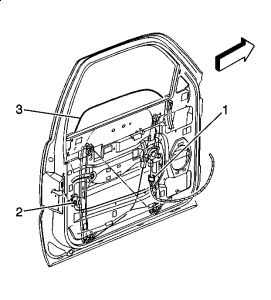

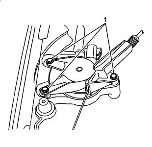

I have removed the RH front door panel on my truck. How do I remove the electric windown motor? I just want to replace the motor, not the entire assembly.
Thanks
Ernie
Aug 5, 2009 at 12:25 AM
DOCFIXIT
  • 18,828 POSTS
Loosen bolts 1-2 in diagram DO NOT REMOVE slide window out of channel support window . Remove three bolts for motor see diagram. Then wiggle motor free of assembly. NOTE position of motor for reinstall
