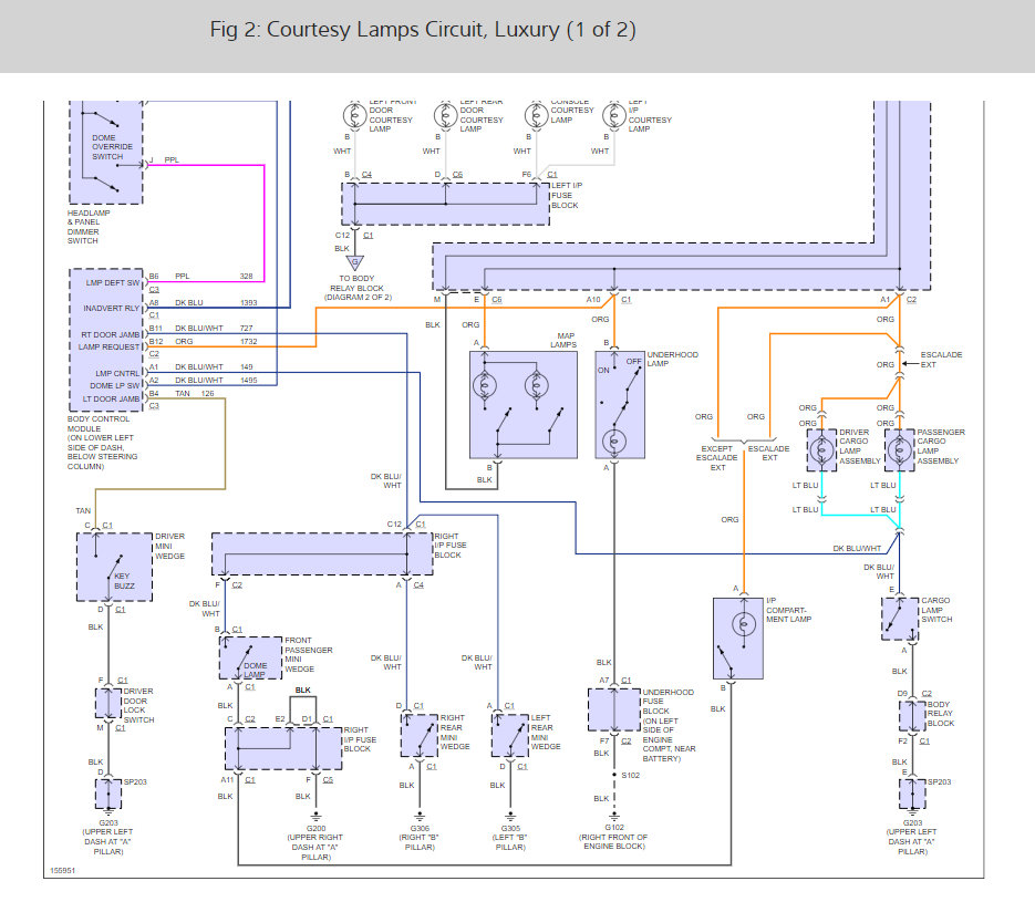

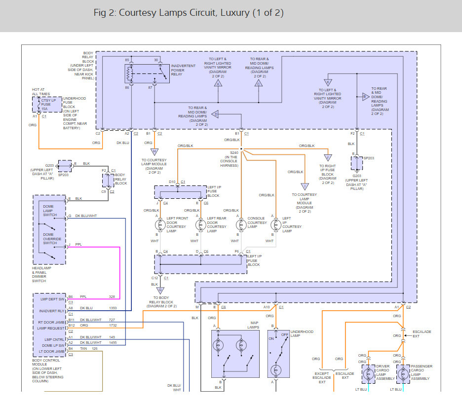

my dome and interior courtesy lights stay on all the time. i've tried to check everything i can think of but no luck yet. am i overlooking something easy or am i going to have to go to an electrical specialist? any ideas?
Mar 8, 2010 at 10:20 AM
  • 110,248 POSTS

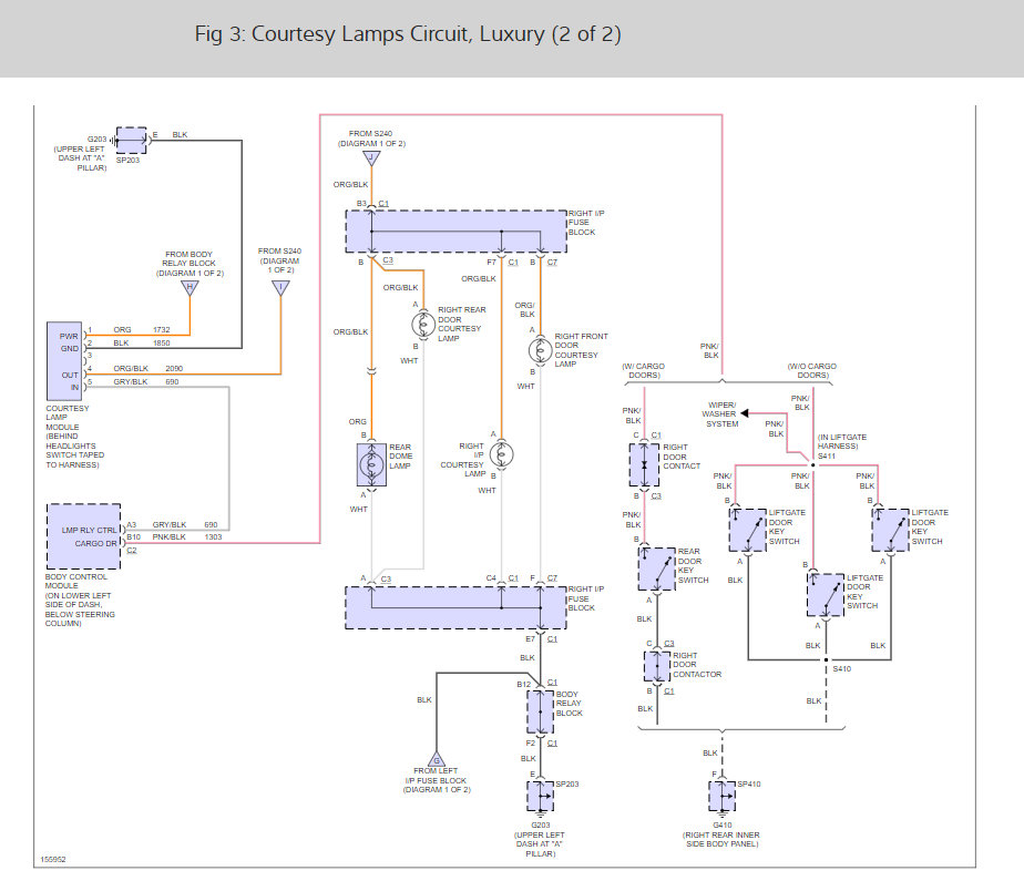

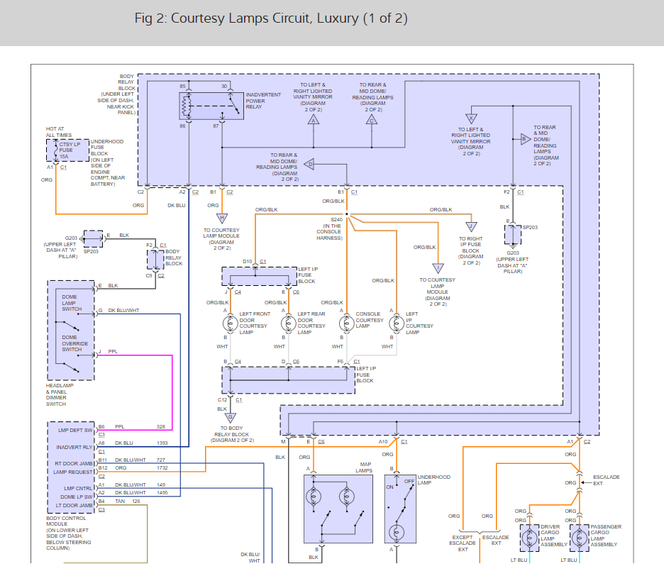

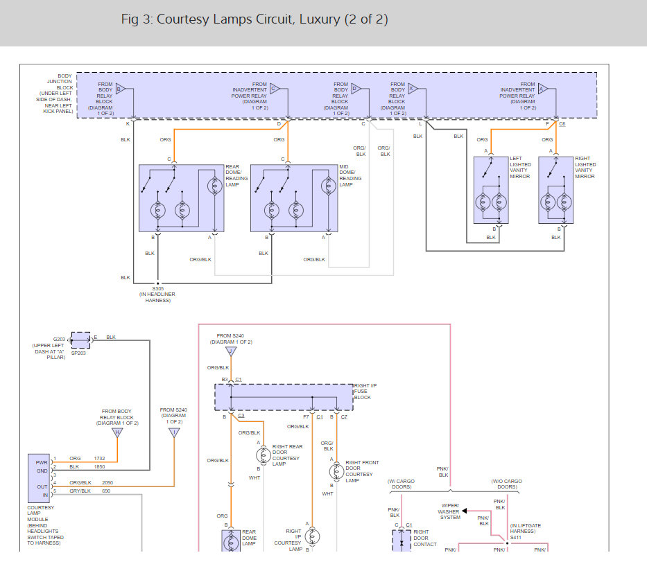

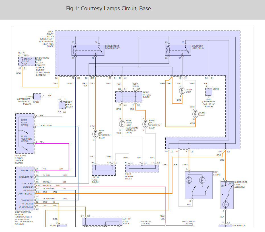

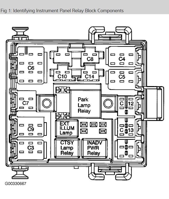

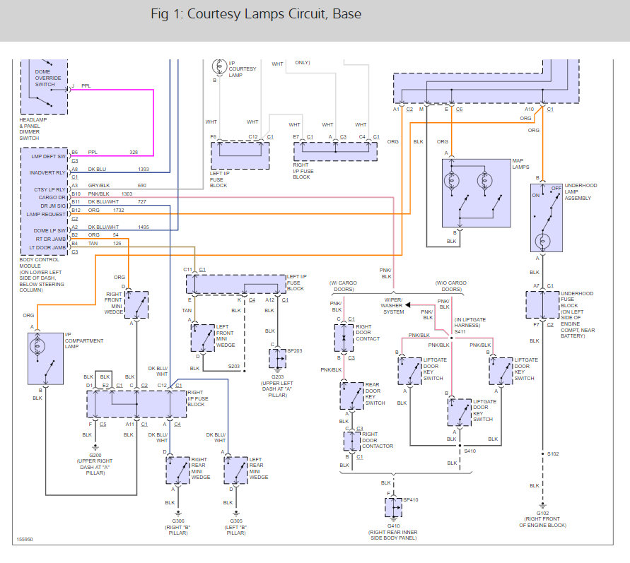

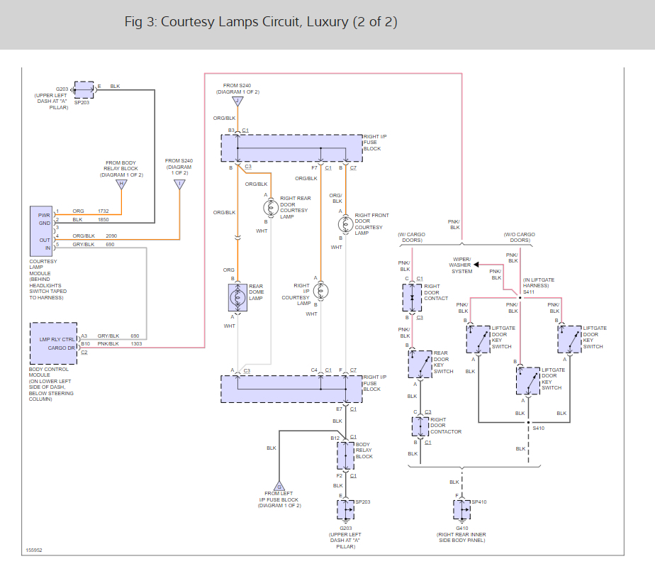

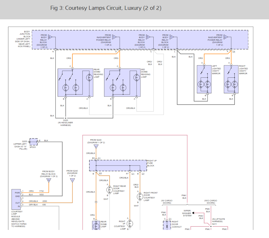

There is a courtesy lamp relay that sounds like it is sticking that needs to be checked. Here is a guide to help us with the relay test and the location including the courtesy light wiring diagrams so you can see how the system works.
Jul 18, 2010 at 4:39 PM
TURBOJAY
Thanks! I had this problem and got a new relay which fixed it cost me $34.00 I love this site.
