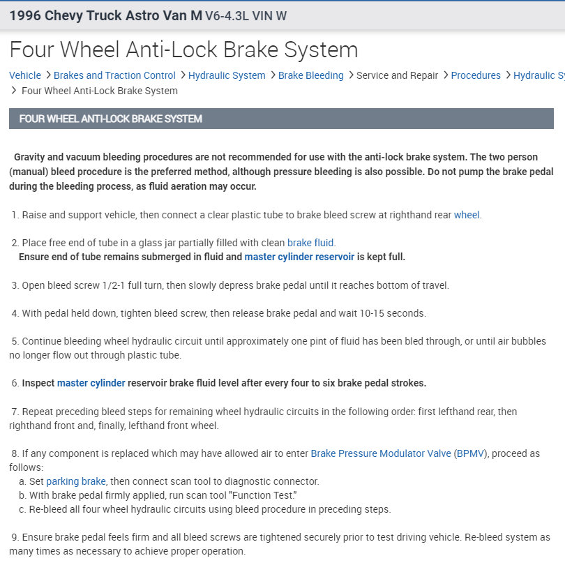

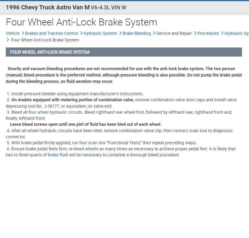

how to bleed a hydro boost system on a 4.3L LS chevy astro with 155500 miles I changed the master cly. and the hydro pump and i still have no power anything. thanks for your help.

The bleeding of the ABS system is little different compared to standard brakes.
When proper procedure does not get followed, it can lead to having air in the lines.
Here is a helpful guide:
https://www.2carpros.com/articles/how-to-bleed-or-flush-a-car-brake-system
I have attached the bleeding procedure for the brakes below.
