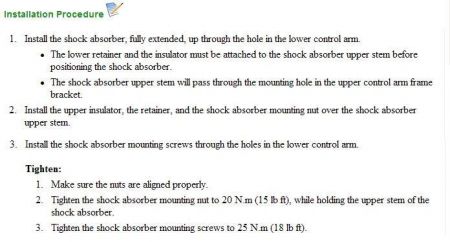

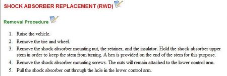

How to change front schocks

Thursday, January 28th, 2010 AT 6:53 PM

Thank s very good. Jim
