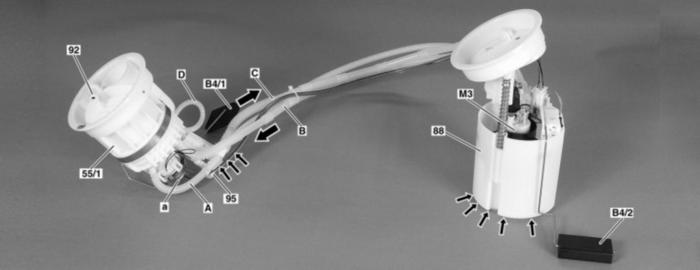

I just filled up my Astro with gas. This is the first time because I just bought it. The gas guage showed almost empty, when I filled it it only came up to a little over half a tank. Where is the problem more likely to be? Is it in the guage or would it more likely be in the tank?

This vehicle is common to have fuel level sensor issues. Which is in the fuel tank. Sometimes if the level sensor is bad it will set a trouble code. Have the vehicle scanned to see if any codes are set.

Take the fuel pump connector loose. Use a resistor on the proper wire terminal, see if the gage reacts properly? Purple wire with white tracer and solid black wire, use proper resistor in between the two terminals, key on. 250 ohm resistor, the gage should show full. 40 ohm resistor, the gage shows empty. If the gage reacts properly, the sending unit in the gas tank is suspect. Radioshack sells resistors, they are cheap.

The fuel gauge problem can be a couple things. However, usually the float rheostat goes bad and sends a bad signal. The bad part is the float is part of the fuel pump (not cheap) and the fuel tank needs removed to replace it. Please keep in mind, there are other things that could cause it. None of which are cheap. The rheostat sends a signal to the body control module (BCM) and then it sends the signal to the gauge. Either could be bad too.

This will be a faulty sender unit with is located in the fuel tank, you will have to get the fuel tank removed and there is a special tool required to unlock the sender retainer before it can be removed, the fuel pump will be mounter with in the sender assembly so this will have to be transferred to new unit.

you'll need to replace the fuel pump. the sending unit gives the gauge reading, which is part of the pump. also the pump is expensive. but you'll need to replace it to fix the problem.
