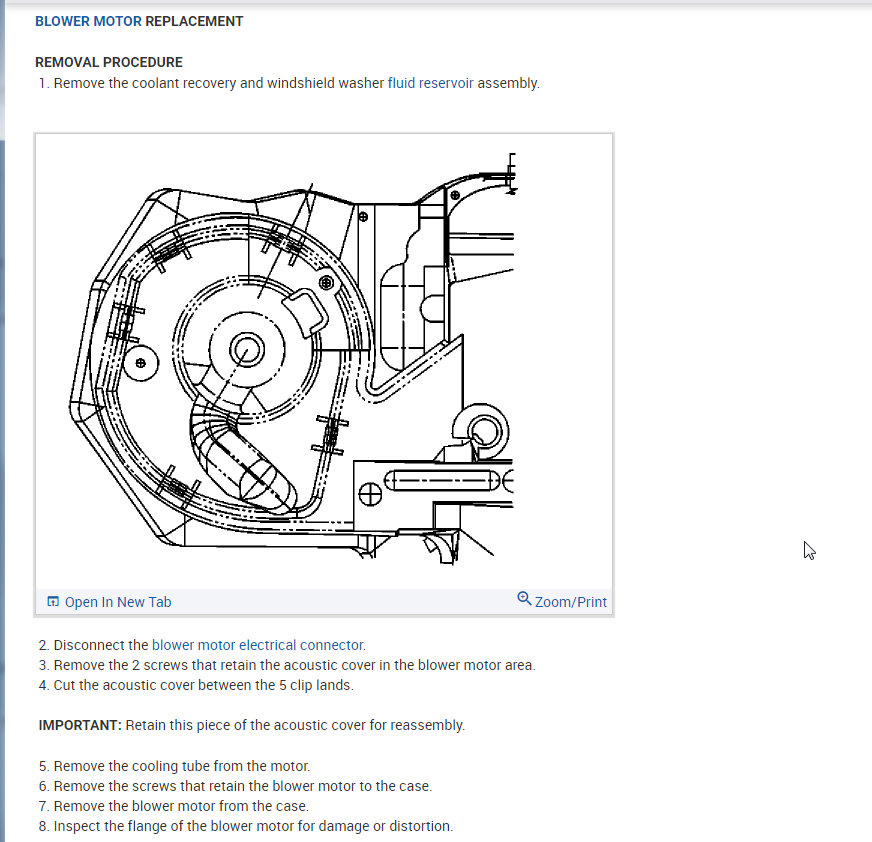

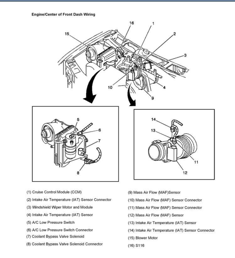

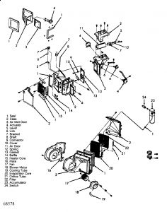

I need to replace it. Is it under the hood or under the dashboard?
Sunday, February 7th, 2010 AT 3:54 PM
12 Replies
It is accessed from under the hood. I am attaching the process from the manual below and location view for your review.

Im trying to replace the ac blower motor. The book says to cut the acoustic cover off. Where exactly do I do that and will I still be abel to use it once I replace the motor
Thursday, February 4th, 2021 AT 9:38 AM (Merged)
WRENCHTECH
  • 20,761 POSTS
That is the thin coat of degraded plastic mounted to the outside of the actual plastic housing. It deteriorates and rarely is reusable. It may even have already been discarded.

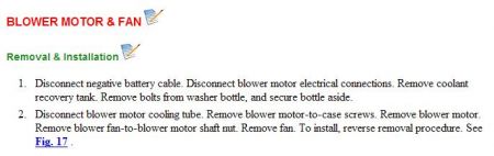

What do I need to remove in order to replace my blower motor on a 99 astro mini van
  • 75,992 POSTS
REMOVAL PROCEDURE
CAUTION: Refer to Battery Disconnect Caution in Service Precautions.
Disconnect the negative battery cable.
Remove the left body side trim panel.
Remove the cooling tube from the case and the motor.
Remove the electrical connectors.
Remove the screws that retain the blower motor to the case.
Remove the blower motor and the fan assembly from the case.

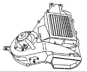

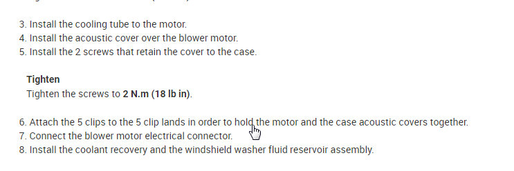

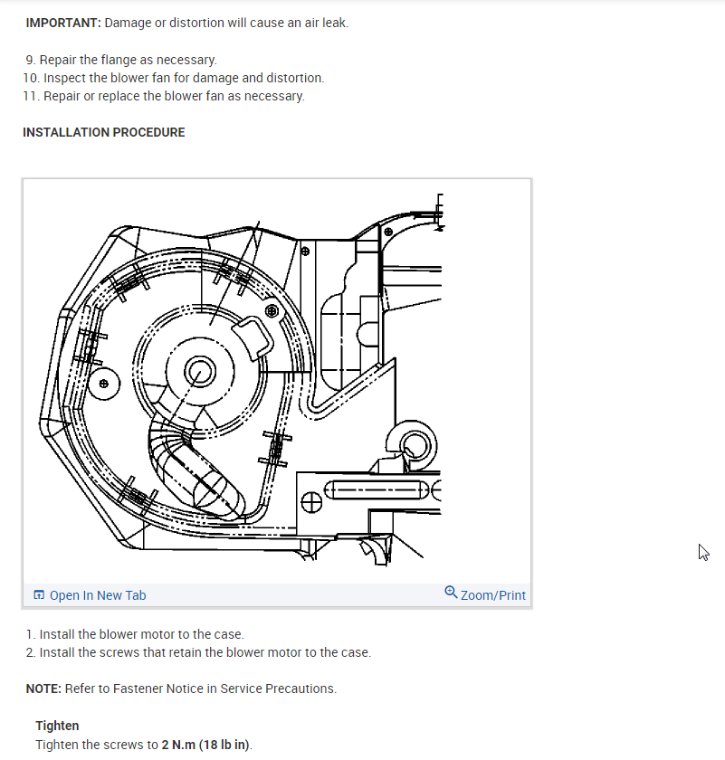

How do you replace the blower motor
BLUELIGHTNIN6
  • 16,542 POSTS
Replacement procedures are below for your vehicle's blower motor..
https://www.2carpros.com/forum/automotive_pictures/261618_Noname_507.jpg
https://www.2carpros.com/forum/automotive_pictures/261618_Graphic_27.jpg

I have a problem with the front heater in my astro. The speed control does not work however on occasion will work. The occasions it does work are becoming fewer. I don't know if the problem is the blower motor and even if it is I don't know where it is located. Can you help me.
CHUBBER22
  • 10 POSTS
My 96 is doing something very similar I only have high speed for the fan. It is the heater relay switch. Mine is located just below the blower motor. Two self-tapping bolts and some water resistant sealent holding it in, one elec conector on it, once you pull it out it looks like a small PC board. $60 at GMC dealer was my quote for the part.

I was wondering if you went from the inside under the dash, or in the engine conpartment to replace the blower motor. If you have step by step instruction that would even be better.
Thank you for your help,
Kelli Peppers
C.BENDZICK
Hi the way you take out the blower motor is to actually go from the engine compartment. You have to remove the windsheild washer bottle and it is behind there. It should be just afew screws and an electrical connection.
HOOP
Chances are its not your motor. Behind your washer bottle you see wires plugging into a back plastic shroud. It seems when you dump cleaner in the bottle. The wires get splashed. Pull the relay out of the black shroud its just a snug fit with tar. After market ones are built better but may not fit properly without some alterations to the hole.I made my own box out of a vcr case and stuck it to the firewall.
