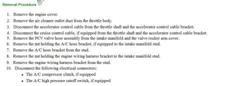

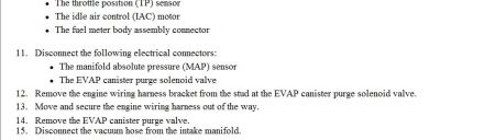

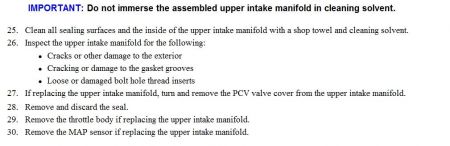

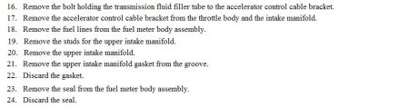

How do you remove upper intake, espectiallly how to remove injector assy from intake as it seems to be holdind the intake from being totally loose from lower intake
Sep 27, 2010 at 3:13 PM
BLUELIGHTNIN6
  • 16,542 POSTS
Hello and thanks for donating Here are the complete removal steps for your vehicle's upper intake manifold. If you need further assistance with this repair feel free to ask..
https://images.2carpros.com/forum/automotive_pictures/261618_Noname_2709.jpg
https://images.2carpros.com/forum/automotive_pictures/261618_Noname2_879.jpg
https://images.2carpros.com/forum/automotive_pictures/261618_Noname3_320.jpg
https://images.2carpros.com/forum/automotive_pictures/261618_Noname4_145.jpg

JIMMY1631
Do you remove the fuel meter body before removing the intake manifold, it seems the upper intake is being held down and if so how do you remove fuel meter body. the upper intake is very loose but something is still holding enough that the intake won't completely turn loose like maby injector wires and fuel lines are holding.
Sep 27, 2010 at 6:20 PM
BLUELIGHTNIN6
  • 16,542 POSTS
follow the steps and it should come off, it is mentioned to disconnect the fuel lines so yes they do need removed before the intake can come out.
Sep 27, 2010 at 11:29 PM
JIMMY1631
Thank you very much for your expert help. Got intake off due to your great advise. Again thank you very much, I will spread the word about your service.
