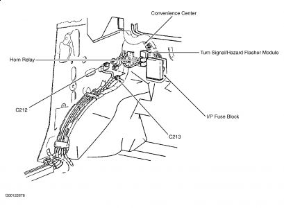

where is localtion on the van
Jul 4, 2009 at 6:05 AM
BLUELIGHTNIN6
Experienced Mechanic
16,542 POSTS
Your vehicle's turn signal / hazard flasher module is located on the convenience center, left side of dash (picture below)...
