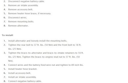

You will have to use your own initiative on some of this. My info is basic. If you see a way to remove alternator that is better than instructions, do it your way. You will have to decide if all instructions apply to your vehicle. The basic info listed, covers several model years, yours included.
https://images.2carpros.com/forum/automotive_pictures/170934_astro_alternator_replace_1.jpg
