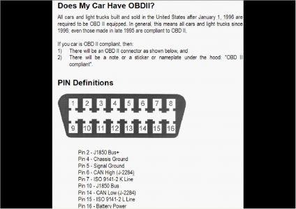

Hi
Where is the valet switch located and what does it look like.
I have new keyless remotes and I want to program them.
Thanks
May 2, 2010 at 3:58 AM
MERLIN2021
  • 17,250 POSTS
REMOTE TRANSMITTER 1. Ground pin 4 to pin 8 of the Data Link Connector (DLC). The receiver will respond as follows: The doors will lock and unlock within 2 seconds. The liftgate window release will be activated within 2 seconds. 2. Simultaneously press and hold the LOCK and UNLOCK buttons on one of the transmitters until the locks cycle. This will take approximately 10 seconds. The receiver will respond as follows. The doors will lock and unlock within 2 seconds. The liftgate window release will be activated within 2 seconds. Do not wait more then 60 seconds between transmitters or the receiver will exit the programming mode. 3. Repeat step 2 for each transmitter, two transmitters can be programed to this vehicle. 4. Remove the jumper wire from the DLC. 5. Verify that the RKE is functioning correctly. Lock and unlock the doors. Activate the liftgate window. REMOTE TRANSMITTER RESYNCHRONIZATION The security method used by the remote keyless entry (RKE) system may occasionally make it necessary for you to resynchronize the system. The RKE transmitter does not send the same signal twice to the receiver, because the receiver does not respond to a signal more than once. This prevents anyone from recording and playing back the transmitter signal. Resynchronization will be necessary if any of the following condition apply:  When the transmitter battery is very weak.  When you replace the battery.  When the vehicle battery is very weak.  When you replace the vehicle battery.  When you disconnect the vehicle battery. Resynchronize the transmitter with the receiver as follows: 1. While standing close to the vehicle, simultaneously press and hold the LOCK and UNLOCK buttons on the transmitter for 7 seconds. 2. The door locks should cycle in order to confirm synchronization. 5/2/2010 ...
https://images.2carpros.com/forum/automotive_pictures/62217_OBD_II_Connector_1.jpg
